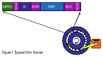

ID Information: Conventionally, space is left in each sector to identify the sector's number and location. This is used for locating the sector on the disk. Also included in this area is status information about the sector. For example, a bit is commonly used to indicate if the sector has been marked defective and remapped.
Synchronization Fields: These are used internally by the drive controller to guide the read process.
Data: The actual data in the sector.
ECC: Error correcting code used to ensure data integrity.
Gaps: One or more "spacers" added as necessary to separate other areas of the sector, or provide time for the controller to process what it has read before reading more bits.
In addition to the sectors, each containing the items above, space on each track is also used for servo information (on embedded servo drives, which is the design used by all modern units).
