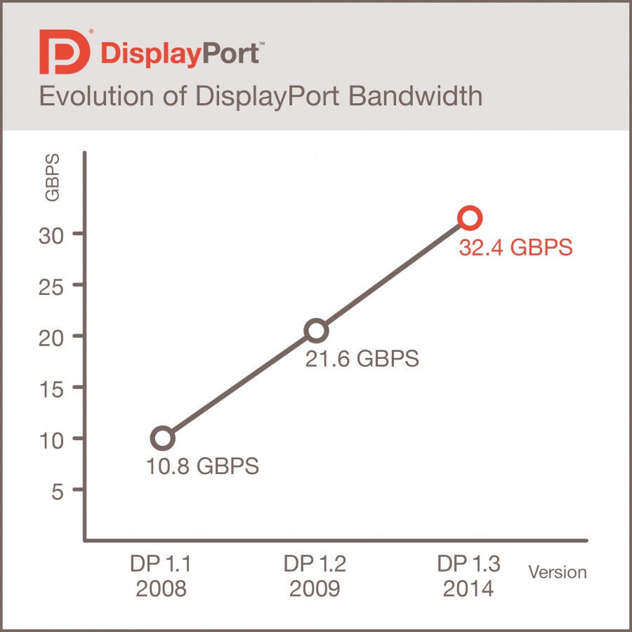

Newark, CA (15 Sep­tem­ber 2014) – The Video Elec­tro­nics Stan­dards Asso­cia­ti­on (VESA®) announ­ced the release of the Dis­play­Po­rt 1.3 audio / video (A/V) stan­dard. An update to the wide­ly used Dis­play­Po­rt 1.2a stan­dard, this latest ver­si­on increa­ses the maxi­mum link band­width to 32.4 Gbps, with each of four lanes run­ning at a link rate of 8.1 Gbps/lane—a 50% increase from the pre­vious ver­si­on of the Dis­play­Po­rt stan­dard. Allo­wing for trans­port over­head, DisplayPort’s 32.4 Gbps com­bi­ned link rate deli­vers 25.92 Gbps of uncom­pres­sed video data.

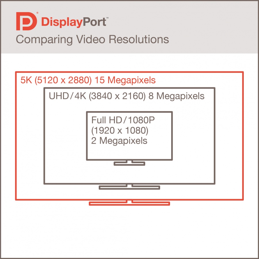

The increased band­width enables hig­her reso­lu­ti­on moni­tors, inclu­ding recent­ly announ­ced 5K moni­tors (with pixel reso­lu­ti­ons of 5120 x 2880) using a sin­gle Dis­play­Po­rt cable, wit­hout the use of com­pres­si­on. It will also enable hig­her reso­lu­ti­ons when dri­ving mul­ti­ple moni­tors through a sin­gle con­nec­tion using DisplayPort’s Mul­ti-Stream fea­ture, such as the use of two 4K UHD moni­tors, each with a pixel reso­lu­ti­on of 3840 x 2160, when using VESA Coor­di­na­ted Video Timing.
