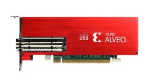

Alveo U50 Data Cen­ter Acce­le­ra­tor Card (PRNewsfoto/Xilinx, Inc.)
The Alveo U50 pro­vi­des cus­to­mers with a pro­gramma­ble low pro­fi­le and low-power acce­le­ra­tor plat­form built for sca­le-out archi­tec­tures and domain-spe­ci­fic acce­le­ra­ti­on of any ser­ver deploy­ment, on-pre­mi­se, in the cloud and at the edge. To meet the chal­lenges of emer­ging dyna­mic workloads such as cloud micro­ser­vices, Alveo U50 deli­vers bet­ween 10–20x impro­ve­ments in through­put, laten­cy and power effi­ci­en­cy. For acce­le­ra­ted net­wor­king and sto­rage workloads, the U50 card helps deve­lo­pers iden­ti­fy and eli­mi­na­te laten­cy and data move­ment bot­t­len­ecks by moving com­pu­te clo­ser to the data.
Powered by the Xilinx® UltraS­ca­le+™ archi­tec­tu­re, the Alveo U50 card is the first in the Alveo port­fo­lio to be packa­ged in a half-height, half-length form fac­tor and low 75-Watt power enve­lo­pe. The card fea­tures high-band­width memo­ry (HBM2), 100 giga­bit per second (100 Gbps) net­wor­king con­nec­ti­vi­ty, and sup­port for the PCIe Gen 4 and CCIX inter­con­nects. By fit­ting into stan­dard PCIe ser­ver slots and using one-third the power, the Alveo U50 signi­fi­cant­ly expands the scope in which adap­ta­ble acce­le­ra­ti­on can be deploy­ed to unlock dra­ma­tic through­put and laten­cy impro­ve­ments for deman­ding com­pu­te, net­work and sto­rage workloads. The 8GB of HBM2 deli­vers over 400 Gbps data trans­fer speeds and the QSFP ports pro­vi­de up to 100 Gbps net­work con­nec­ti­vi­ty. The high-speed net­wor­king I/O also sup­ports advan­ced appli­ca­ti­ons like NVMe-oF™ solu­ti­ons (NVM Express over Fabrics™), dis­ag­gre­ga­ted com­pu­ta­tio­nal sto­rage and spe­cia­li­zed finan­cial ser­vices applications.
