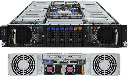

Tai­pei, Tai­wan, Sep­tem­ber 3rd 2020GIGABYTE Tech­no­lo­gy, (TWSE: 2376), an indus­try lea­der in high-per­for­mance ser­vers and work­sta­tions, today announ­ced two new G‑series ser­vers, G292-Z44 and G292-Z24, for sci­en­ti­fic com­pu­ting, AI, as well as data ana­ly­tics. GIGABYTE G‑series ser­vers are desi­gned for GPGPU depen­dent workloads. With the addi­ti­on of Broad­com® PCIe swit­ches, GIGABYTE ser­vers have enhan­ced the poten­ti­al for GPU com­pu­ting by expan­ding the num­ber of con­nec­ted GPUs while impro­ving latency.

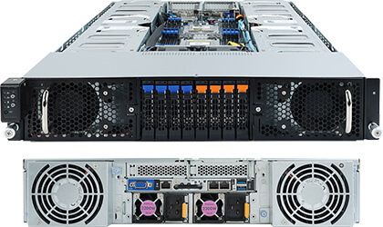

Model Name G292-Z44 G292-Z24
Pro­ces­sors Dual Sin­gle
Memo­ry 8‑channel DDR4
16 DIMMs (up to 4TB) 8 DIMMs (up to 2TB)
Speed up to 3200MHz
PCIe Slots 8 x PCIe x16 slots (Gen4 x16) for GPUs
2 x PCIe x16 (Gen4 x16) low-pro­fi­le slots
LAN 2 x 10GbE BASE‑T LAN
1 x GbE MLAN
2 x 10GbE SFPLAN
1 x GbE MLAN
Sto­rage 4 x SATA/SAS and 4 x U.2 6 x SATA/SAS and 2 x U.2
