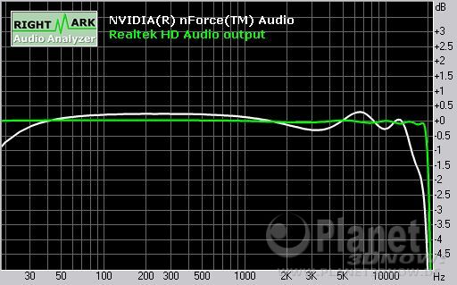

Fre­quen­cy respon­se (from 40 Hz to 15 kHz), dB: +0.30, ‑0.78 +0.02, ‑0.09

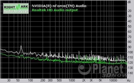

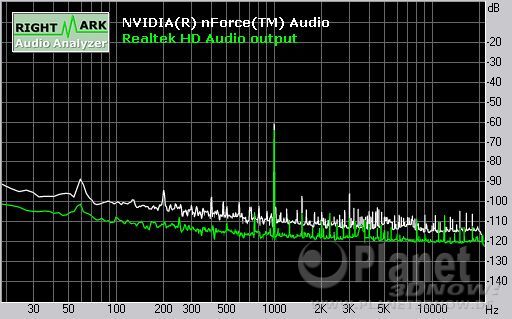

Noi­se level, dB (A): -80.6 -86.3
Dyna­mic ran­ge, dB (A): 80.1 86.0

Fre­quen­cy response
Soundqualität Foxconn A79A-S: Frequency Response
Noi­se level
Soundqualität Foxconn A79A-S: Noise Level
Dyna­mic range
Soundqualität Foxconn A79A-S: Dynamic Range

Fre­quen­cy respon­se (from 40 Hz to 15 kHz), dB: +0.02, ‑0.09 Excel­lent
Noi­se level, dB (A): -86.3 Good
Dyna­mic ran­ge, dB (A): 86.0 Good
